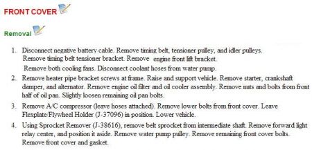

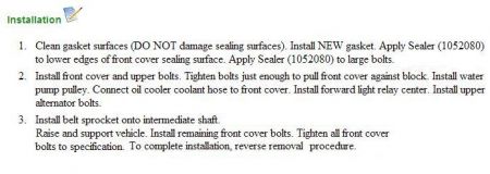

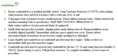

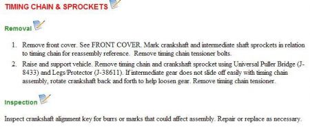

what tools needed to replace a timing chain on a 1991 pontaic grand prix 3.4 liter engine. thank you..leo
