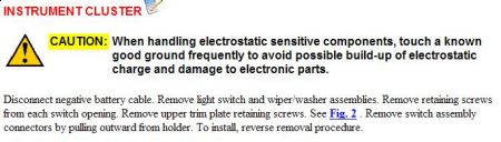

1991 Pontiac Grand Prix inst cluster removal
1991 PONTIAC GRAND PRIX
BLUESHARP
Electrical problem
1991 Pontiac Grand Prix 6 cyl Front Wheel Drive Automatic
how do I remove the inst. cluster to replace burnt out bulbs
Jul 27, 2009 at 10:48 PM
BLUELIGHTNIN6
  • 16,542 POSTS
https://images.2carpros.com/forum/automotive_pictures/261618_Noname_749.jpg

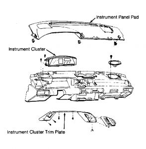

FIG. 2
https://images.2carpros.com/forum/automotive_pictures/261618_Graphic_98.jpg
Jul 28, 2009 at 6:31 AM
