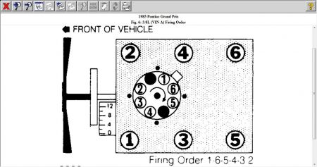

i am tring to find the fring order for a 81 grand prix pontiac. i need the wire numbers and order for pluging them in.

Try this
https://images.2carpros.com/forum/automotive_pictures/12900_fo_76.jpg
