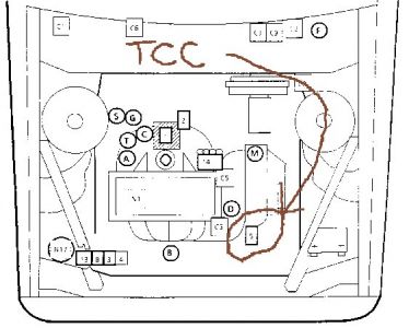

Ok i have a 1990 grand am 2.5L 170K whever i am driving about 55-70 the torque converter locks up due to the lockup solenoid... and when i stop my car dies.. i restart put it in drive it dies... its does this forever... eventually it will quit and i can drive again... is there any way i can disable this or what can i do to fix it??? its doesnt always do this but its has done it a bunch lately im estimating every 4 out of 10 stoplights/signs

It probably needs a tcc solenoid. However, you can unplug it and try it that way.

how do i unplug it???

Look at the connector, there are a couple tabs or fingers that lock the connector on, lift them and pull back with the body of the connectors, NOT by the wires.
https://images.2carpros.com/forum/automotive_pictures/30961_tcc_1.jpg

ok and ur positive this wont fry my transmission or nothing like that lol

This isn't a long term solution, but a way to help isolate your problem. My brother has been driving his like that for 3 years :roll:

The TCC lockup solenoid likely needs replacement. As a temporary diagnostic test, unplug its connector by lifting the locking tabs and pulling on the connector body, not the wires. Driving with it unplugged is only for isolating the problem, not a long-term fix.
