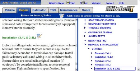

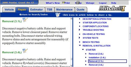

Need to change starter on 2000 pontiac grand am how much trouble will it be?
Friday, November 9th, 2007 AT 1:26 PM
MECHANIC
75,992 POSTS
Vehicle Information Inadequate-See below pick your engine
