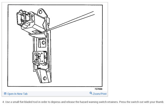

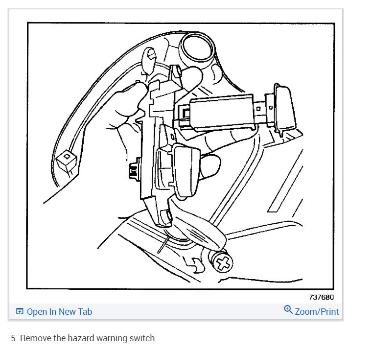

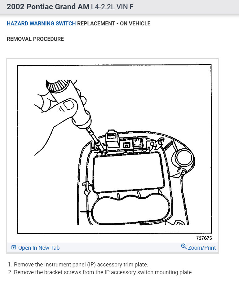

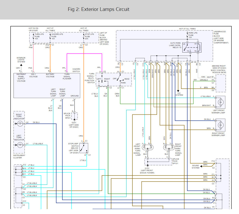

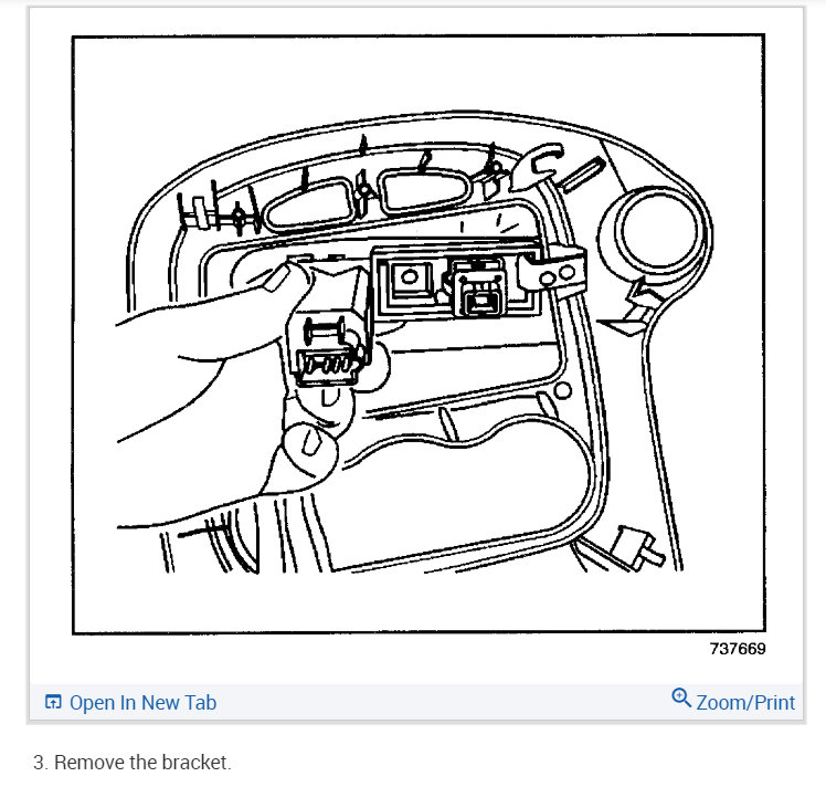

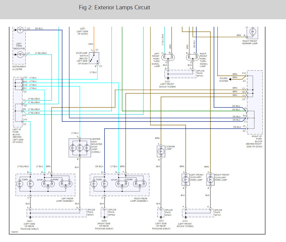

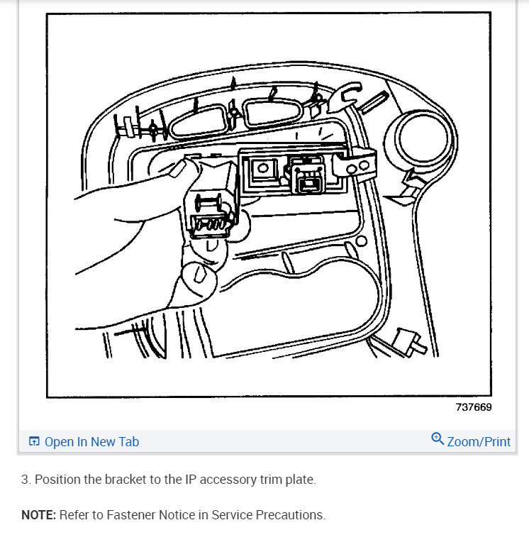

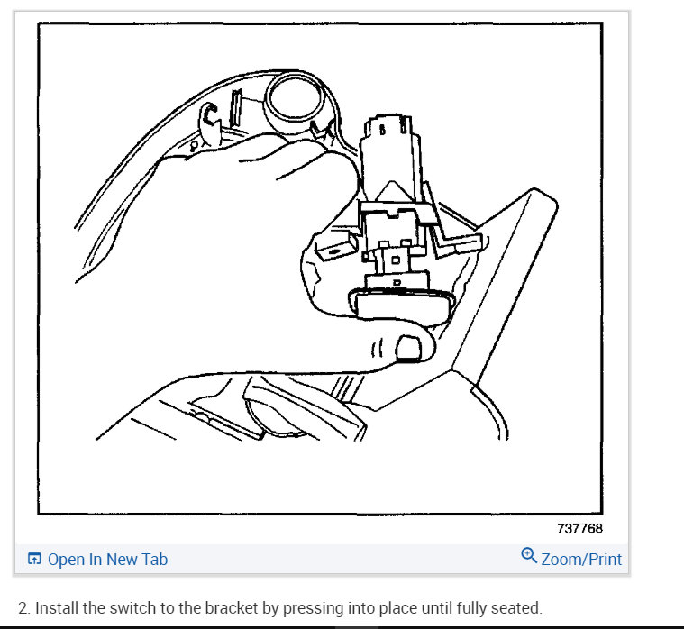

Yep, it sounds like they missed a bad turn signal switch, lets fix this ourselves here is a guide to help check the power and ground of the system with the blinker wiring diagrams so you can see how it works.
Check out the diagrams (Below). Please let us know what you find. We are interested to see what it is.
Jun 19, 2020 at 5:09 AM (Merged)
JAYMAN94
Thank you for this post I checked the problem out using the guide above and found the hazard switch was no good which is the flasher too. got a new one for 76.00. Here is the location in the diagrams below.
