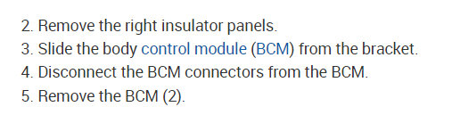

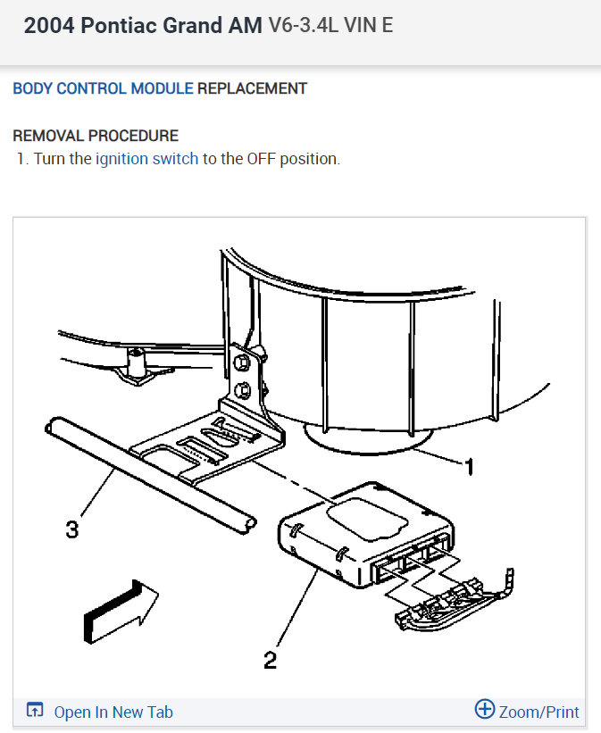

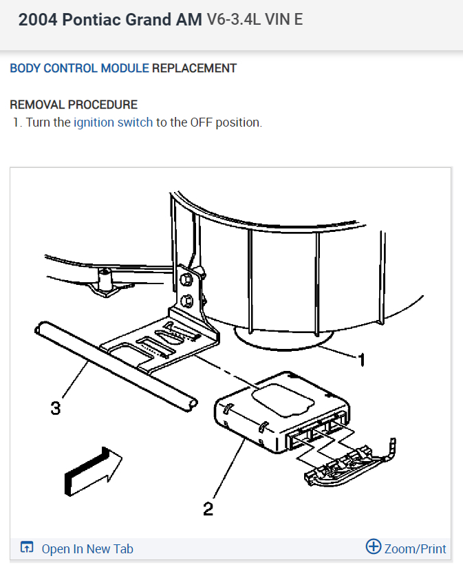

I would need to say I think it is the BCM because it hangs down low on the passenger side, it may have got wet and shorted it out. a CAN scan will tell us for sure. You can get a CAN scanner (Controller Area Network) which will work on most cars from Amazon.
https://youtu.be/u-4syLc-ifQ
Here is a generic guide to help you step by step with instructions in the diagrams below to show you how on your car:
https://www.2carpros.com/articles/how-to-replace-a-bcm-body-control-module
