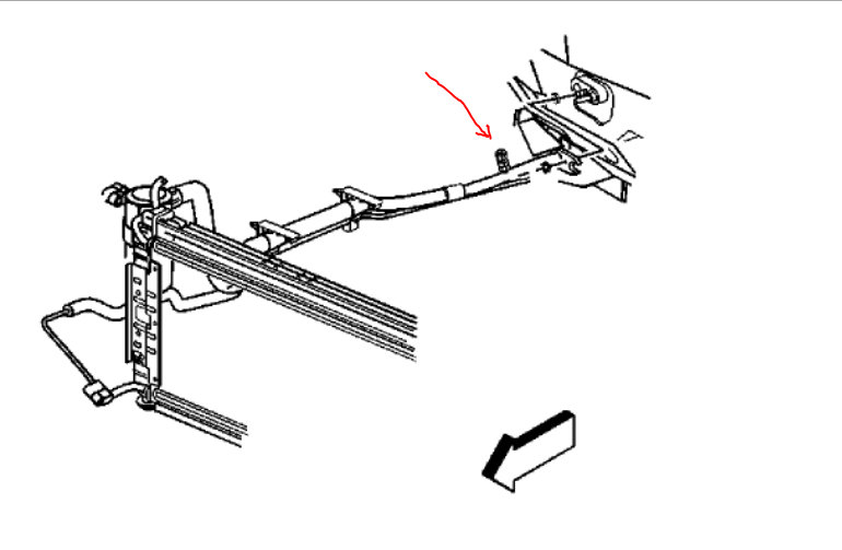

Is there a low side service port.
2003 PONTIAC GRAND AM
CAROLYN VANCE
Air Conditioning problem 6 cyl Front Wheel Drive Automatic 15878 miles
when service rhe a/c where does the freon goes in? and is there a low side port if so can you pleas show me a diagram?
Apr 17, 2010 at 1:37 PM
  • 54,861 POSTS

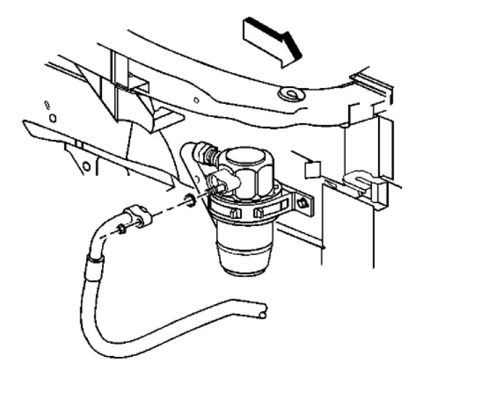

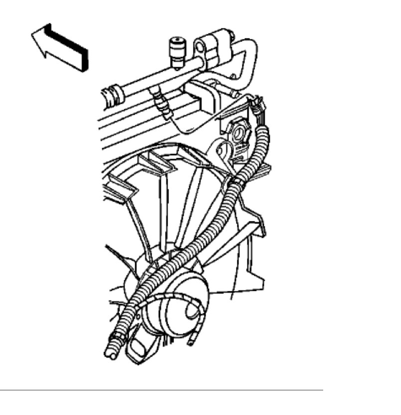

The lower side service port is located on the large tube headed from the firewall to the rear of the compressor. Here is a diagram and some guides to help you get the job done. Low side port is featured by a red arrow. (below)
