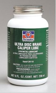

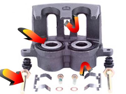

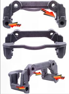

Here are a few thoughts. Did you use a high quality caliper grease in all the right places?

1. No I did not apply caliper grease to all of the locations noted. I will do this when I replace the pads, shortly,
