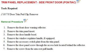

my driver side window seems to be off the track, could you please tell me the way to get the inside panel off so i can fix it. The window motor works but the window just drops to the bottom and then i have to help it up any and all help is welcomed Thank you Mike

https://images.2carpros.com/forum/automotive_pictures/261618_Noname_1526.jpg
https://images.2carpros.com/forum/automotive_pictures/261618_Noname2_458.jpg
