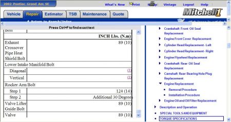

what are the torque specification on the rocker arm bolts for the 3.4 L

See below
https://images.2carpros.com/forum/automotive_pictures/12900_rocker_bolt_torq_1.jpg
