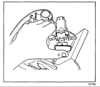

The blinkers and hazard lights work properly. Once I use either one the sound of the blinker stays on and wont stop until I turn the car off. Can you tell me what needs to be replaced and how I can replace it?
Nov 7, 2008 at 4:21 AM
IMPALASS
  • 3,112 POSTS

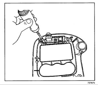

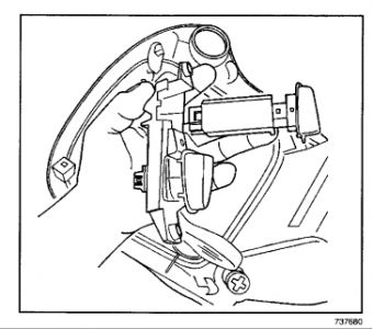

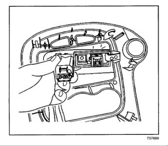

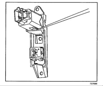

Hello -- I would think it is a defective Hazard warning switch. On your model the Hazard Flasher and Turn Signal Flasher have been integrated with the Hazard Lamp Switch. I have attached how to change. HAZARD WARNING SWITCH REPLACEMENT - ON VEHICLE REMOVAL PROCEDURE
https://images.2carpros.com/forum/automotive_pictures/248015_1_38.jpg
Remove the Instrument panel (IP) accessory trim plate. Remove the bracket screws from the IP accessory switch mounting plate.
https://images.2carpros.com/forum/automotive_pictures/248015_2_26.jpg
Remove the bracket.
https://images.2carpros.com/forum/automotive_pictures/248015_3_22.jpg
Use a small flat-bladed tool in order to depress and release the hazard warning switch retainers. Press the switch out with your thumb.
https://images.2carpros.com/forum/automotive_pictures/248015_4_11.jpg
Remove the hazard warning switch. INSTALLATION PROCEDURE
https://images.2carpros.com/forum/automotive_pictures/248015_5_7.jpg
Position the hazard warning switch to the bracket.
https://images.2carpros.com/forum/automotive_pictures/248015_6_3.jpg
Install the switch to the bracket by pressing into place until fully seated.
