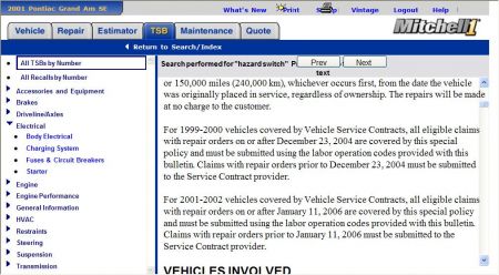

The turn signals work sometimes and sometimes they do not. Inside the dashboard somewhere by the radio there is a sound just like when I turn my signals on when they work. I checked the light bulbs and fuses. Any help will be very helpful. Thanks.
Jun 20, 2008 at 5:48 PM
  • 75,988 POSTS

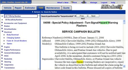

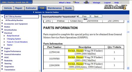

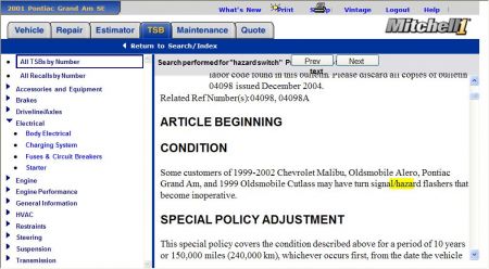

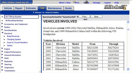

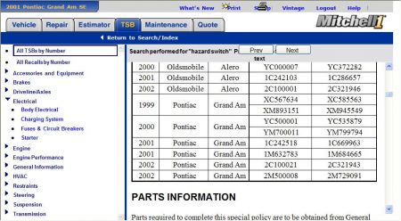

Bring it in to the dealer this problem has a TSB The turn signal flasher and the hazard flasher are both integrated in to the hazard warning switch on the dash,this is acually called a Hazard Warning module
