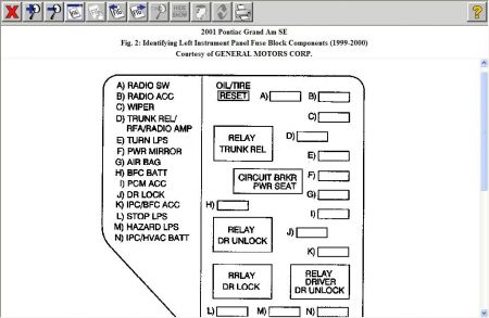

The turn signals do not come on and blink and I can not find which fuses are for the turn signals.

E Turn Lps see below
https://images.2carpros.com/forum/automotive_pictures/12900_turn_signal_2.jpg
