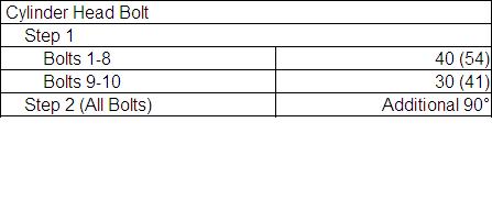

2001 Pontiac Grand Am 4 cyl Front Wheel Drive Automatic
i need head torque specs for 2.4 liter
Dec 8, 2009 at 2:27 PM
JDL
  • 16,098 POSTS
Welcome, the first numbers in the right hand column are foot lbs.
https://images.2carpros.com/forum/automotive_pictures/170934_torque_specs_2.jpg
