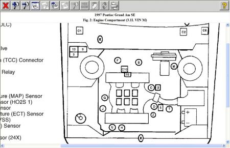

I have a p0122 engine fault code which I am told is the throttle positionsensor, but where is the sensor located on the car.
Sep 16, 2008 at 11:41 AM
  • 75,992 POSTS
See below
https://images.2carpros.com/forum/automotive_pictures/12900_tps_9.jpg

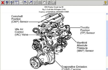

Where is the Throttle Position Senor located and how do you change it?
Dec 5, 2019 at 3:51 AM (Merged)
  • 75,992 POSTS
Its on the throttle body assembly see location C below-mark the old one before you remove it and put the new one on exactly how the old one was positioned.
https://images.2carpros.com/forum/automotive_pictures/12900_tps_21.jpg
