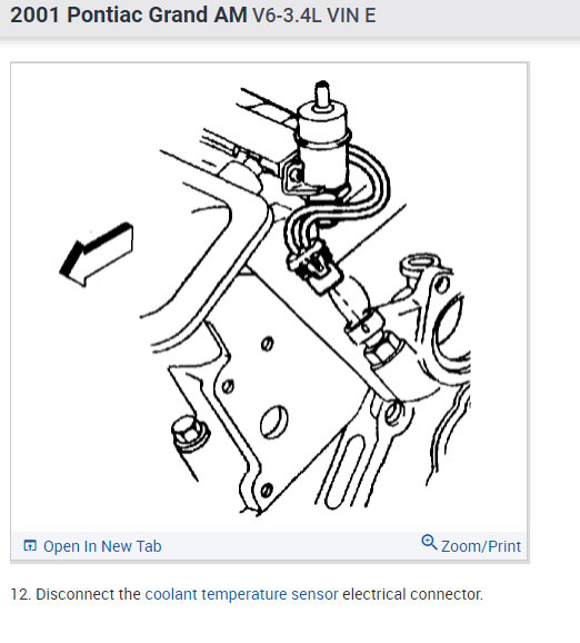

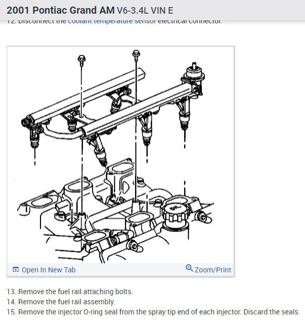

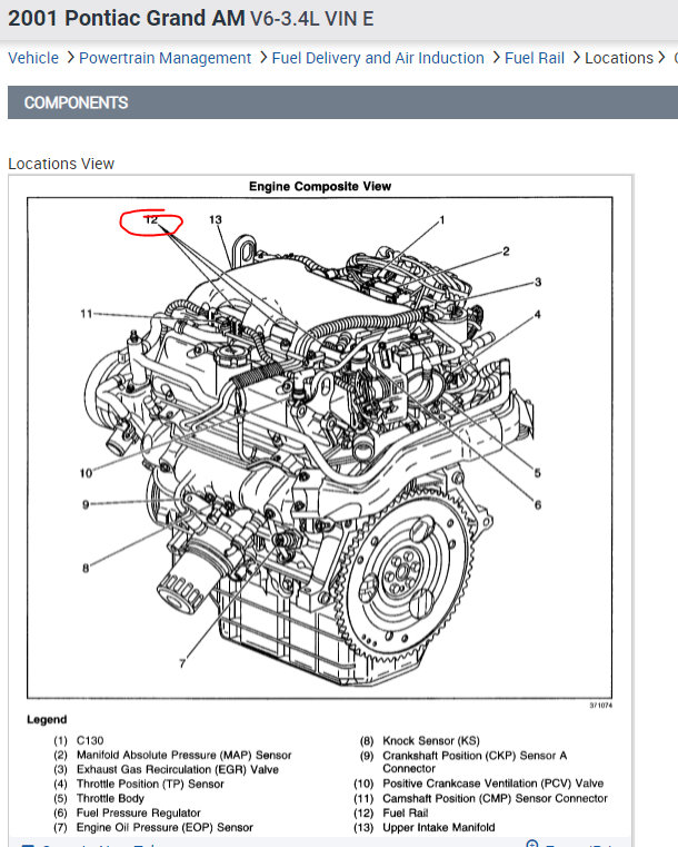

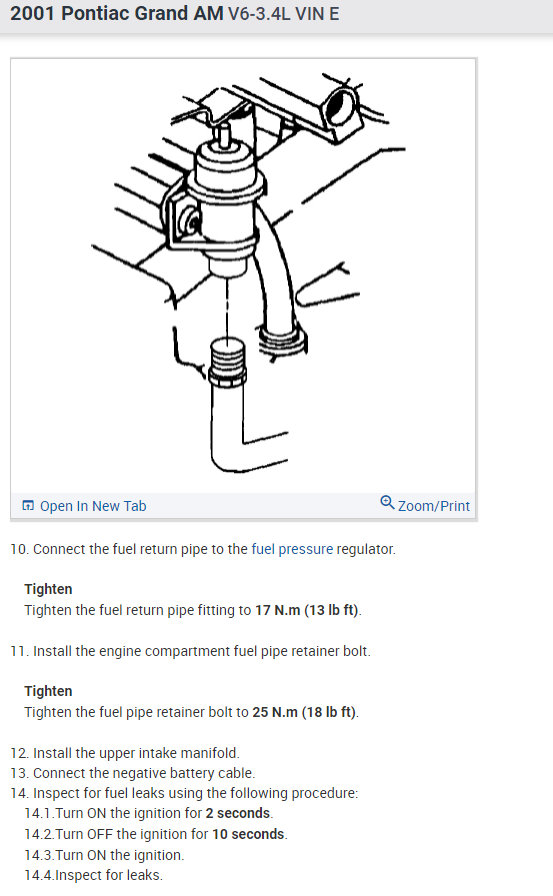

My 9 year old Pontiac reeks of gasoline when I start the engine. When I pull out of a parking spot, I do not visibly see a puddle of gas or any signs of leakage from under my car. The smell goes away after I drive my car for a while, and does not return until the next time when I start my engine.
