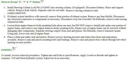

how do you change a rack and pinion? Do I have to drop the sub frame? How many hours to change?

https://images.2carpros.com/forum/automotive_pictures/261618_Noname_2777.jpg
