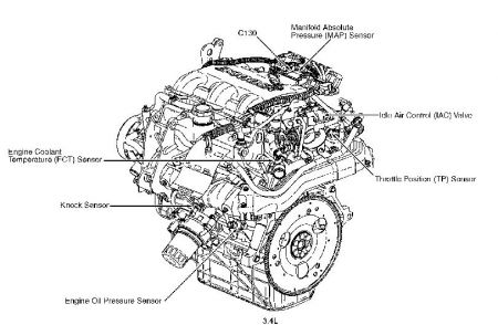

My fans won't turn on and my car is over heating. Also blowing out a lot of smoke. Just has an oil change and put antifreeze in it. Would the engine coolant temp. sensor being bad cause the fan not to run? Is there a way to test it before buying a new one? What else could it be? What can I do my self and what should I take to a garage?

Check your fan relays located in the underhood fuse block. Relays are simple to check and remove so I am sure you can do this step. For information on how to check a relay, follow the link below:
https://www.2carpros.com/how_to/how_do_i_check_a_relay.htm
Is the smoke white or light grey ? If so, this may indicate that you have run the vehicle's engine too hot and cracked a head gasket or other gasket, allowing coolant to be leaked into the combustion chamber and burnt through the exhaust. This will need to be checked out at a repair shop, so they can perform proper procedures with their equipment to see what exactly was damaged.
Post your results of relay tests and I will follow up.

All relays clicked when tested. And are you sure that the only thing that could cause the smoke is a gasget. The smoke is white. However, I just changed my oil and my oil was dirty but I read online that it would have a milky color to it and bubbles on the dip stick. My oil had neither of these. Thank you for you response and I hope you can help me out a little more with this new information. Thank you again!

Is smoke coming from exhaust or engine compartment? If is from exhaust then yes, I am certain about the smoke.. White smoke from exhaust indicates coolant being burnt (unless it is just condensation, not actual smoke). Dark grey or black smoke means too much fuel to system or oil being burnt.. In this case it is coolant (or condensation, so check your coolant level). Next thing to test will be the temperature sensor. Sometimes when they fail it wil never turn on the fan. Also test the fan to make sure it actually works. You can usally test the fan motor to see if it works by turning the A/C on, which wil automatically turn the fans on by default. The coolant temperature sensor is located on top left rear of engine, pictured below.
https://images.2carpros.com/forum/automotive_pictures/261618_Noname_181.jpg
