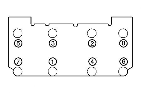

What is the bolt tightening patern for the rear head...is it just a miror image of the front?

it is just a mirror image,
https://images.2carpros.com/forum/automotive_pictures/147643_head_1.jpg
