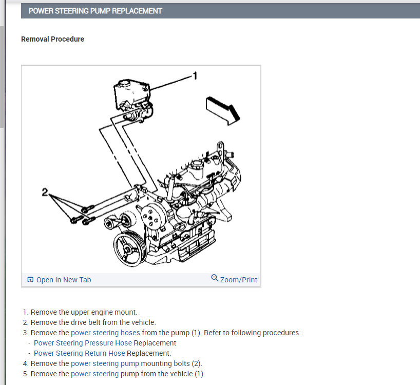

My car is leaking power steering fluid, the pump needs to be replaced.
Tuesday, January 27th, 2009 AT 12:23 PM
MECHANIC
18,907 POSTS
If the pump is leaking then you will need to replace it. So here are a couple guides that will help with this:
https://www.2carpros.com/articles/power-steering-problems
https://www.2carpros.com/articles/how-to-replace-a-power-steering-pump

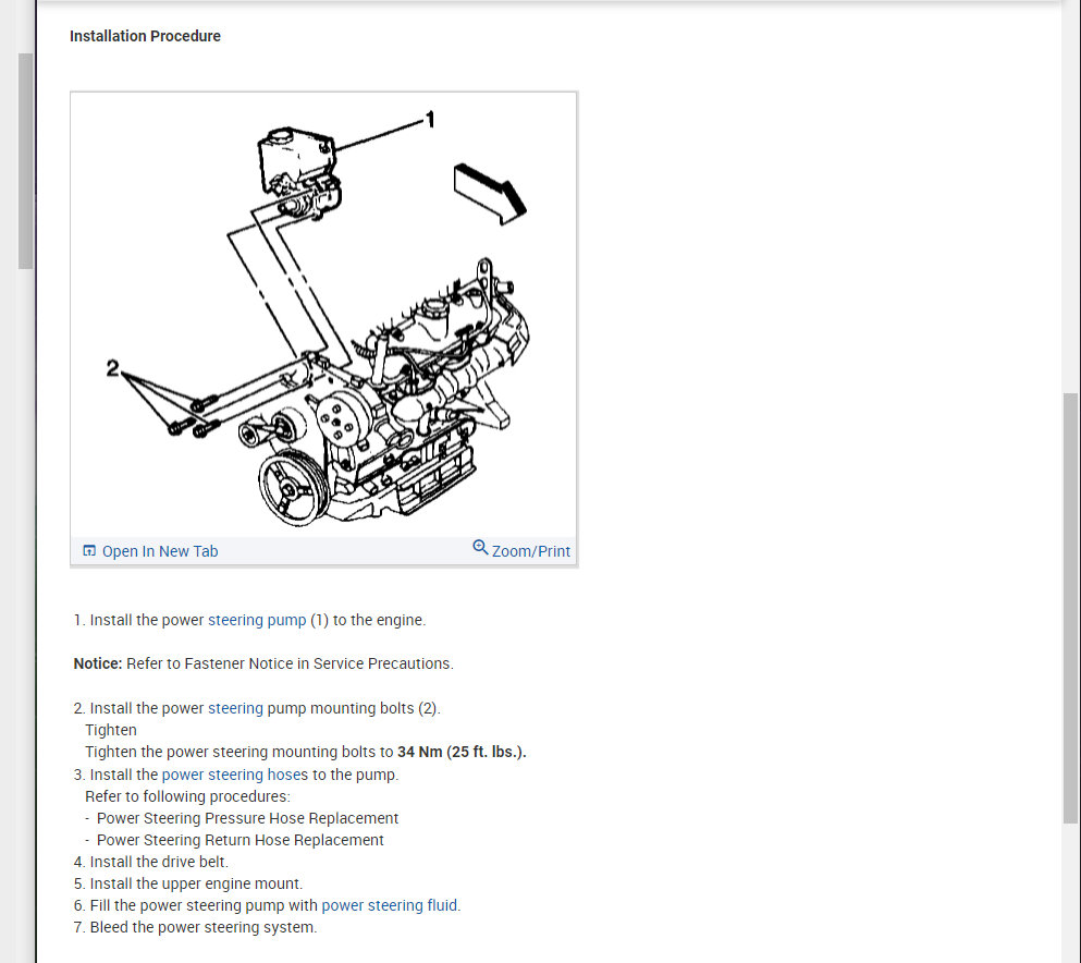

Once we run through that material, below is the process from the manual that will give the additional details including the torque specs needed to complete this.
Please run through this material and let us know if you have questions.
