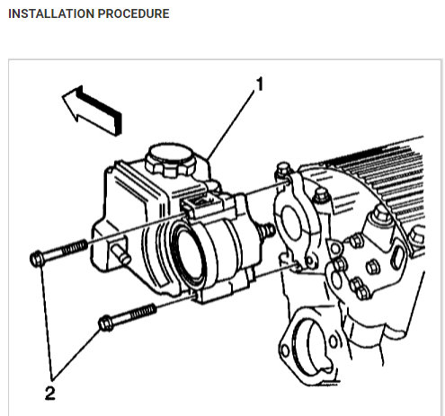

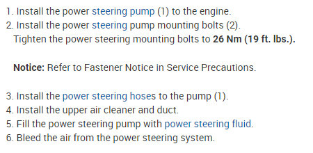

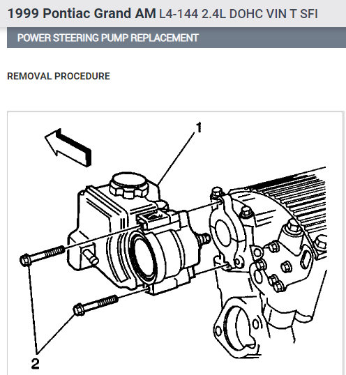

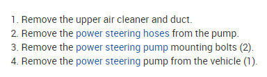

Here is the information you requested. Here is a tutorial showing what is involved for replacing a power steering pump:
https://www.2carpros.com/articles/how-to-replace-a-power-steering-pump
I've attached picture steps below showing how to replace the power steering pump on your car. Hope this helps and thanks for using 2CarPros.
