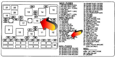

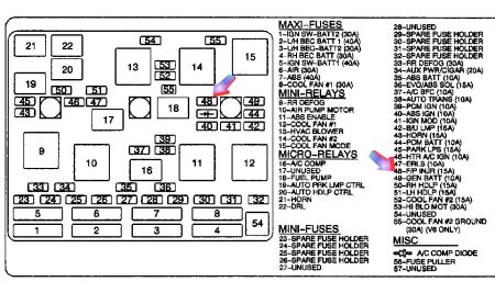

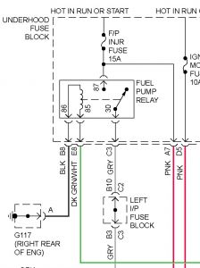

I need to know if my 2001 Grand Am fuel pump has a reset switch. Unable to get the car crank since running out of gas. Add $10 worth of gas into tank. The car is acting like it is still out of gas. I do not hear a humming sound for the fuel pump. Perform the spark plug test and it fires, purchse a new battery 6 months ago. Please help!!!
Oct 3, 2007 at 7:36 AM
SERVICE WRITER
  • 9,123 POSTS
I believe there is a fuse and a relay. Maybe you didn't run out of gas, maybe it quit pumping. There is no reset button.
Oct 3, 2007 at 8:24 AM
TISD2001DALE
Where is the fuse located and what relay? Where is the relay located? Are you talking about the fuel pump relay switch?
Oct 3, 2007 at 8:46 AM
SERVICE WRITER
  • 9,123 POSTS

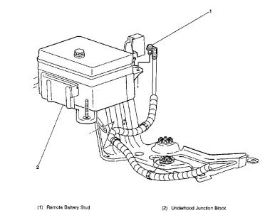

There is no reset. Under the hood there is a box. Relay:
https://images.2carpros.com/forum/automotive_pictures/30961_fuse_2.jpg
https://images.2carpros.com/forum/automotive_pictures/30961_fude_1.jpg
Fuse:
https://images.2carpros.com/forum/automotive_pictures/30961_fu2_1.jpg
https://images.2carpros.com/forum/automotive_pictures/30961_fu1_1.jpg
