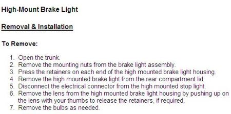

One of the light bulbs in the center (cyclops) brake light is burned out. I've tried to pull out the brake light holder from the inside of the trunk lid, but it doesn't want to come out and I don't want to force anything for fear of breaking it. Is there a technique to getting this thing out to replace the bulb?

https://images.2carpros.com/forum/automotive_pictures/170934_high_mount_1.jpg
I came across the above info, it may not help?
