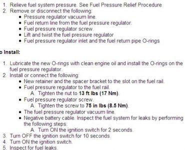

fuel pressure regulator how to install new one

https://images.2carpros.com/forum/automotive_pictures/170934_pontiac_grandam_1.jpg
