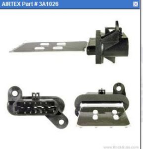

Welcome to the forum, is it the resistor block you want to replace?
https://images.2carpros.com/forum/automotive_pictures/170934_2000_pontiac_resistor_block_1.jpg

I have removed the glove box.
I can see the blower housing.
The top of the blower housing tilts back and the blower wheel spins free.
I cannot find where to put the rplacment part.
It has a 6 prong female fitting, and a 2 by 4 "card" attached that has printed circuits and 4 nodules.

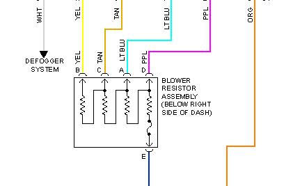

https://images.2carpros.com/forum/automotive_pictures/170934_blower_resistor_picture_1.jpg
https://images.2carpros.com/forum/automotive_pictures/170934_blower_resistor_assembly_wiring_colors_1.jpg
I tried to find an exploded view of the system, haven't found it yet. Look at the color of the wiring to the resistor connector. Are we talking about the same part? As far as location, my info just says attached to blower housing.

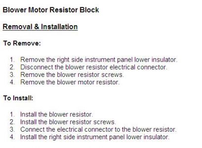

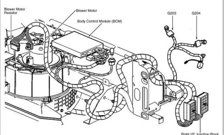

I found this for the grand am GT.
https://images.2carpros.com/forum/automotive_pictures/170934_grand_am_GT_blower_resistor_1.jpg
