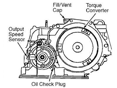

where is the dipstick to add the transmission fluid to a pontiac grand am 1999

You may not have one! 4T40-E & 4T45-E 1. Fluid level must be checked at temperature of 104 °F (40 °C). To obtain proper temperature, perform the following:  Idle vehicle for 3-5 minutes.  Shift into each gear position, holding in each position for 3 seconds. 2. Place gear selector in Park. Raise and support vehicle. Place oil drain pan below oil check plug. Oil check plug is located in center of transaxle above pan rail, on torque converter side. See Fig. 9 . Remove oil check plug. Fig. 9: Locating 4T40-E & 4T45-E Oil Check Plug Courtesy of GENERAL MOTORS CORP. 3. Oil level should be at bottom of oil check plug hole. If fluid does not drain from hole, add fluid until fluid starts to pour from hole. Tighten oil check plug to 10 ft. lbs. (14 N.m). CAUTION: DO NOT overfill transmission. When transmission is hot, one pint of fluid will raise fluid level from ADD 1 PT. or .5L mark to FULL HOT mark on dipstick. Page 1 of 1 SERVICING - A/T -1999 Pontiac Grand Am SE 3/1/2009

on the 99 and newer grand ams they removed the tranny dipstick so that you will have to have it serviced by a gm machanic
