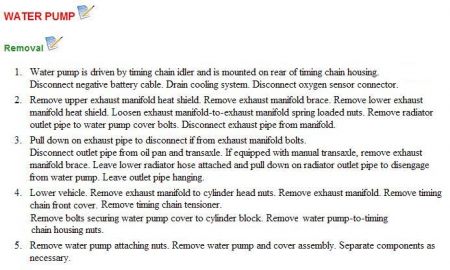

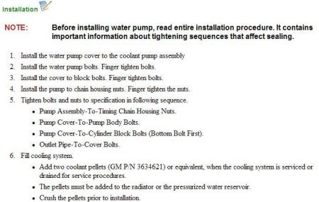

1999 Pontiac Grand Am 4 cyl Front Wheel Drive Automatic
i have to change my water pump is it hard to do and digram to so oyou how to its a 2.4 twin cam
Sunday, December 13th, 2009 AT 5:51 PM
BLUELIGHTNIN6
MECHANIC
16,542 POSTS
+1
Sunday, December 13th, 2009 AT 7:50 PM
