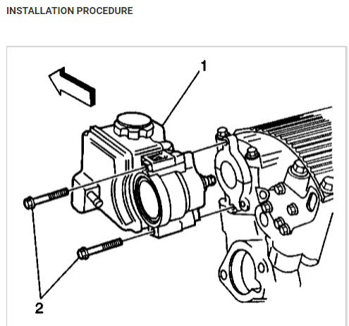

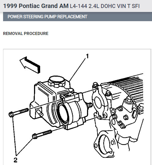

I have a grinding noise when i turn my wheel to the right and only the right. So I'm pretty sure it's not power steering troubles. A mechanic told me to get this replaced would cost anywhere from 200 to 400 dollars. Is that true? Also how difficult is the procedure?
Jun 2, 2010 at 6:24 PM
DANNY L
  • 5,648 POSTS
Hello, I'm Danny.

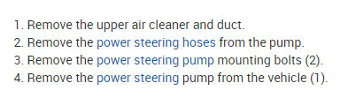

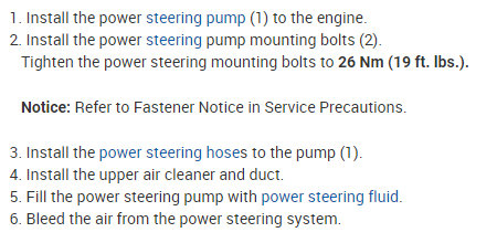

Here is the information you requested. Here is a tutorial showing what is involved for replacing a power steering pump:
https://www.2carpros.com/articles/how-to-replace-a-power-steering-pump
I've attached picture steps below showing how to replace the power steering pump on your car. Hope this helps and thanks for using 2CarPros.
