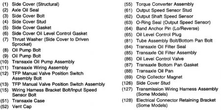

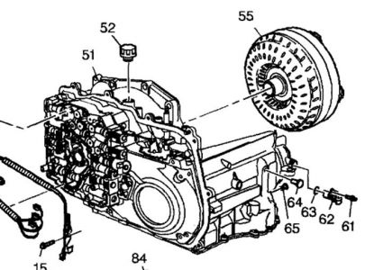

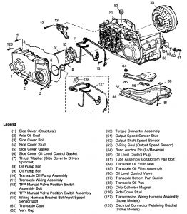

The oil level control plug is located @ #65 as shown below:

Can you make it a little big.
