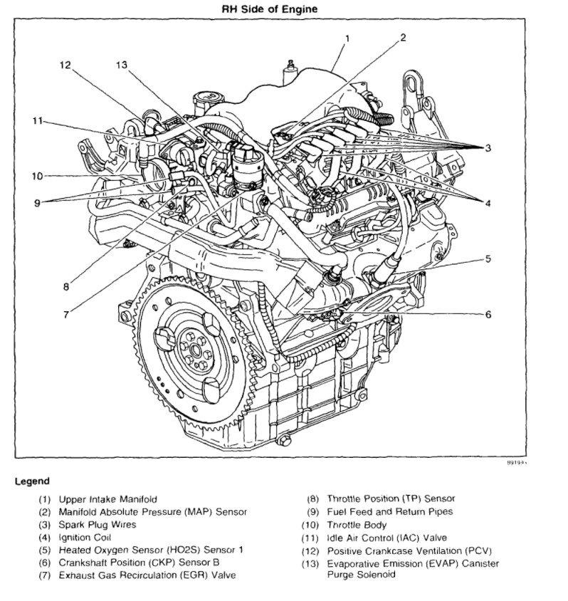

Where is the bank 1 sensor 1 located on a 1999 Grand AM
Monday, May 4th, 2009 AT 4:37 PM
16 Replies
  • 75,992 POSTS
This guide can help us with the diagrams below showing the oxygen sensor location.
https://www.2carpros.com/articles/how-to-replace-an-oxygen-sensor
Check out the diagrams (Below). Please let us know what you find.

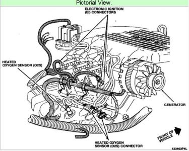

BRENDAL LEE GILES
  • 1994 PONTIAC GRAND AM
  • 6 CYL
  • FWD
  • 177 MILES
Where is the oxygen sensor located in 1994 Pontaic Grand AM? So I can replace sensor
Thursday, December 3rd, 2020 AT 8:17 AM (Merged)
  • 75,992 POSTS
https://www.2carpros.com/forum/automotive_pictures/12900_os_4.jpg
LH rear of engine compartment.

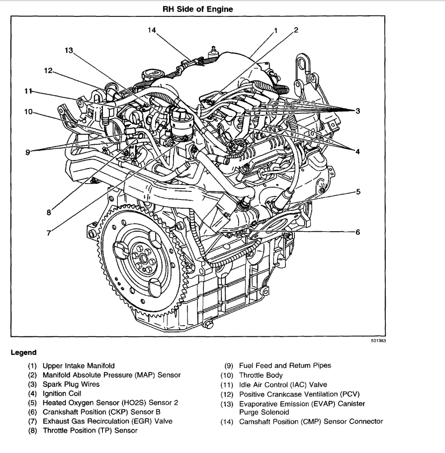

AMAN31
  • PONTIAC GRAND AM

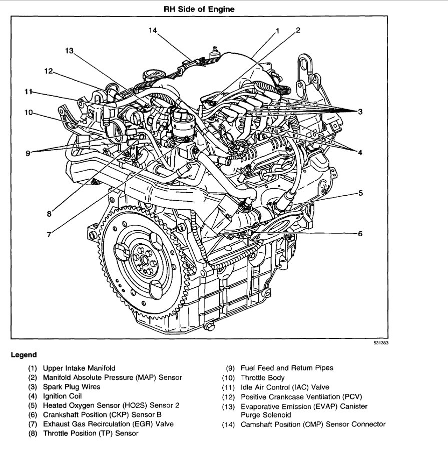

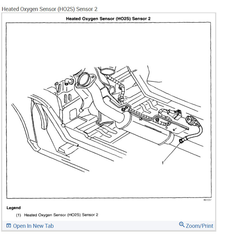

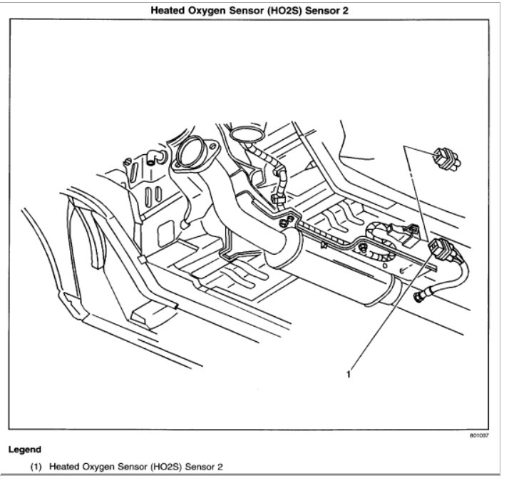

Hi I have a 1999 pontiac grand am 2.4l 4 cyl with 82000 miles. 2 weeks ago my check engine light came on so it took it to 2 different auto parts stores and they hooked it up to the code reader. Both times it came up with the code po141 which is the oxygen sensor. It also says that it is bank 1 sensor 2. Can you tell me which sensor that is and where it is located? Is it an easy fix that I can do my self? Thank so much
STLTHRIOT
  • 31 POSTS
Here is the sensor locations for both the 4 and 6 cylinder engines. Make sure you use a factory sensor or the gas mileage will suffer.
Here is a guide to help you see what you are in for.
Cheers
AMAN31
Yea I did notice a drop with a cheap sensor. Bank 1 sensor 2 was the one that is the 02 sensor that is the one right after the catalytic converter BTW
