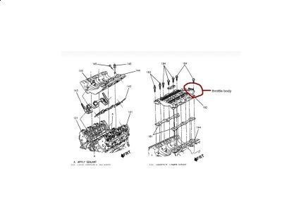

Thanks so much for the reply! The light is working, but no it isn't on. I found an image of how to find the throttle body, but do you have a suggestion of how I can find where the IAC valve is located? Also, the coil pack issue had been mentioned to me so we will look into that. Is there a way to test it to make sure I have the correct one replaced? Thanks again.
https://images.2carpros.com/forum/automotive_pictures/356693_throttle_body_1.jpg

IAC is on throttle body and is device that regulates or "fine tunes" idle. No real reliable way for the DIY'er to measure coil output, most shops can measure coil output. IAC:
https://images.2carpros.com/forum/automotive_pictures/108325_GA_IAC_2.jpg
