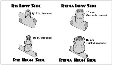

Where is the low service port so I can recharge the system with R134a?

Look around for the 13mm fitting-see below
https://images.2carpros.com/forum/automotive_pictures/12900_ac_service_fittings_22.jpg
