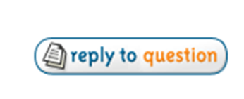

Hey - you reposted..........to answer me back just click on the "reply to question" at the bottom
https://images.2carpros.com/forum/automotive_pictures/248015_Smaller_Reply_2.png

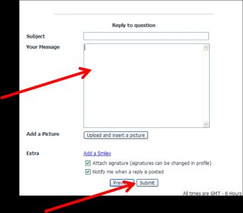

Then that will take you to the below page...............
https://images.2carpros.com/forum/automotive_pictures/248015_Message_Example_1.jpg
Enter your response etc in the Your Message area that the red arrow is pointing to then once you have all of that the way you want, hit the "submit" button that the second arrow is pointing to.
