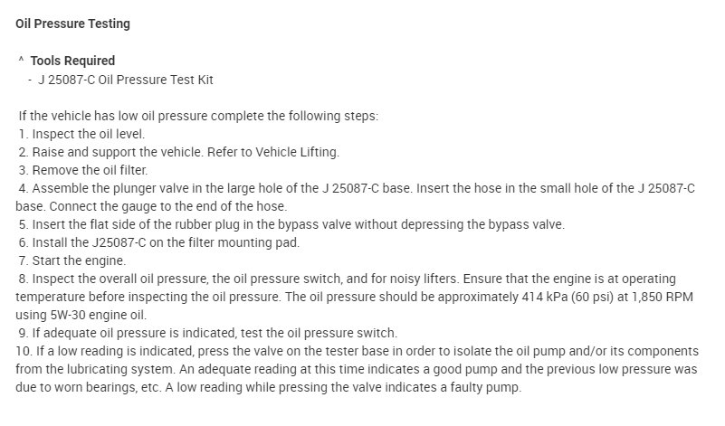

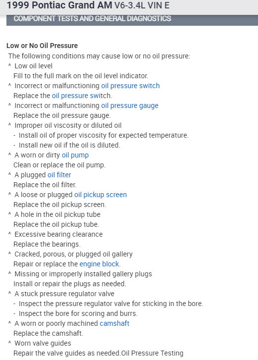

First you want to make sure that the engine oil level is correct. Low oil level can create nose of this nature.
If the oil level is good but still hear the noise, might want to check the oil pressure. If the oil pump does not provide adequate pressure, the upper part of the engine will not get oil and will make noise and can-do permanent damage.
The oil pressure can be tested using a test gauge. Which can be rented from your local auto parts store.
This engine should have 15 PSI of oil pressure at 1100 RPM.
https://www.2carpros.com/articles/high-or-low-engine-oil-pressure

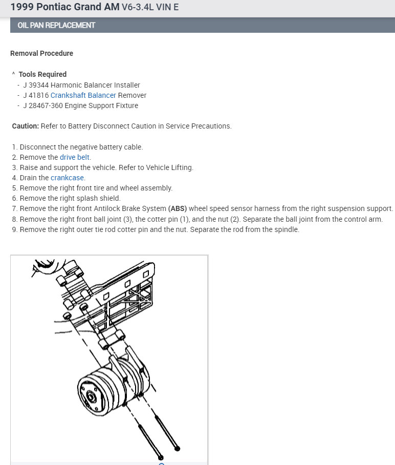

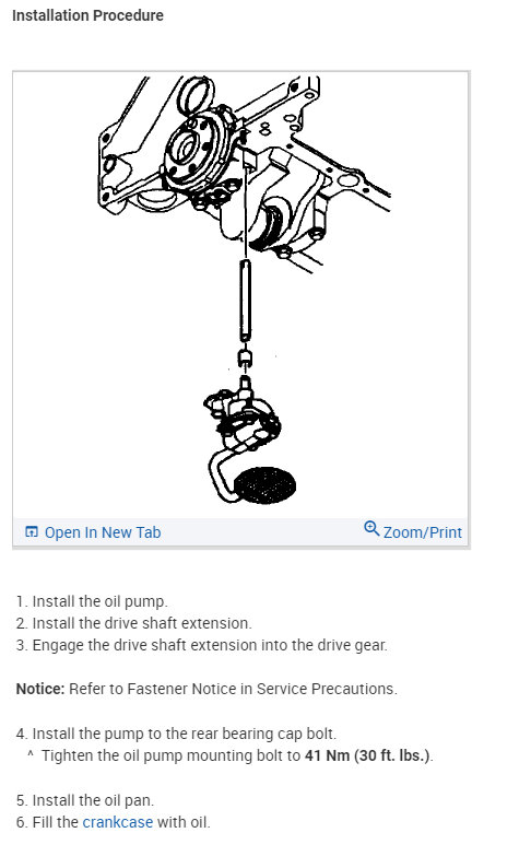

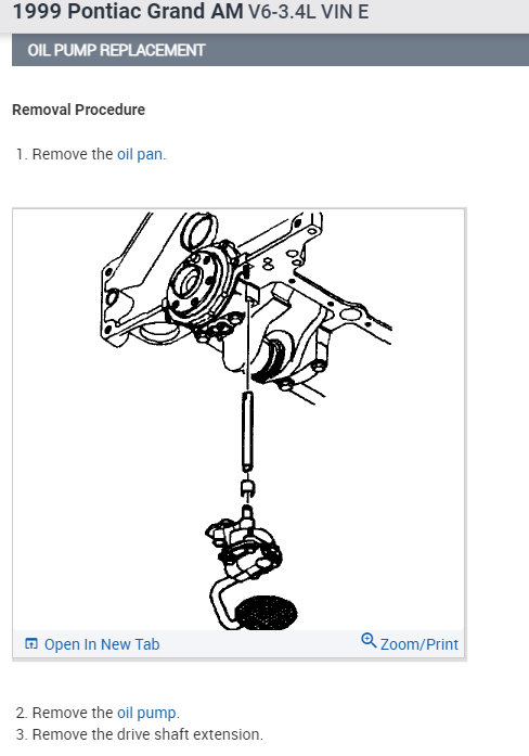

Low oil pressure can be due to a bad oil pump. It can also be due to a clogged oil screen for the pickup tube.
