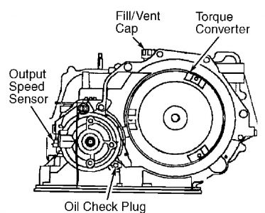

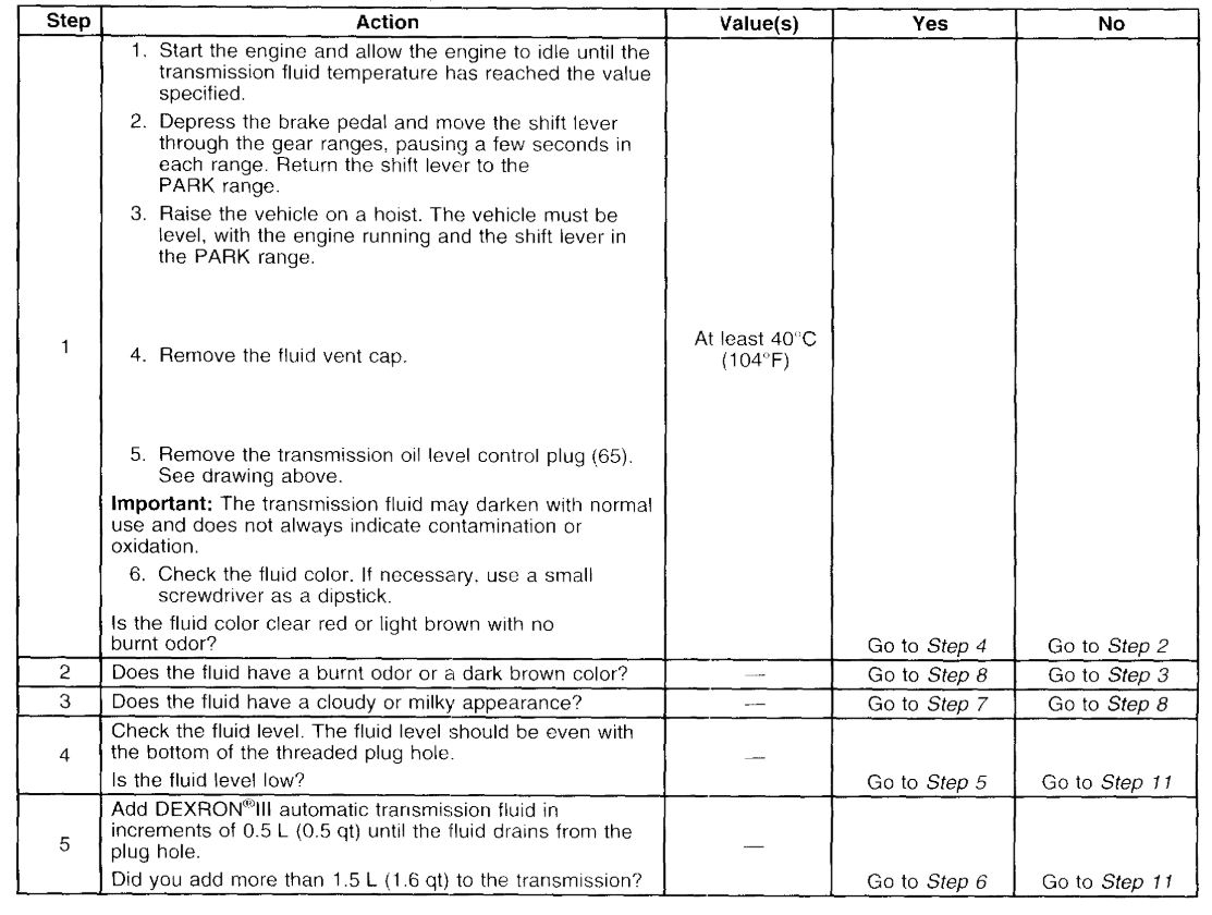

I recently bought this car it it the GT model. I have tried to check the transmission fluid and could not find where to do so. I had someone else look and they found it, but when they opened it up there was no dipstick to check it with. Are we missing something?
Monday, December 17th, 2007 AT 6:26 PM
12 Replies
BRIAN 1
  • 1,030 POSTS
It does not have a dip-stick. Here is how you add fluid: Start the engine and allow the engine to idle until the transmission fluid temperature has reached the value specified.
Depress the brake pedal and move the shift lever through the gear ranges, pausing a few seconds in each range. Return the shift lever to the "park" range. Remove the fluid vent cap.
Raise the vehicle on a hoist. The vehicle must be level, with the engine running and the shift lever in the "park" range. Caution: The engine must be running when the transmission fluid fill plug is removed, or excessive fluid loss will occur. The transmission fluid may be hot. Since the actual fluid level is unknown, stand clear when removing the fill plug. Have a container ready to capture any lost fluid. Do not turn the engine off with the fill plug removed, as you can be injured by hot transmission fluid being expelled out of the oil fill opening.
Remove the transmission oil level control plug.
https://www.2carpros.com/forum/automotive_pictures/147643_trans_1.jpg
This transmission only has a fluid vent cap that you can unscrew to add fluid.
Post back with any other questions.

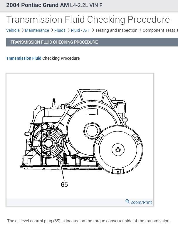

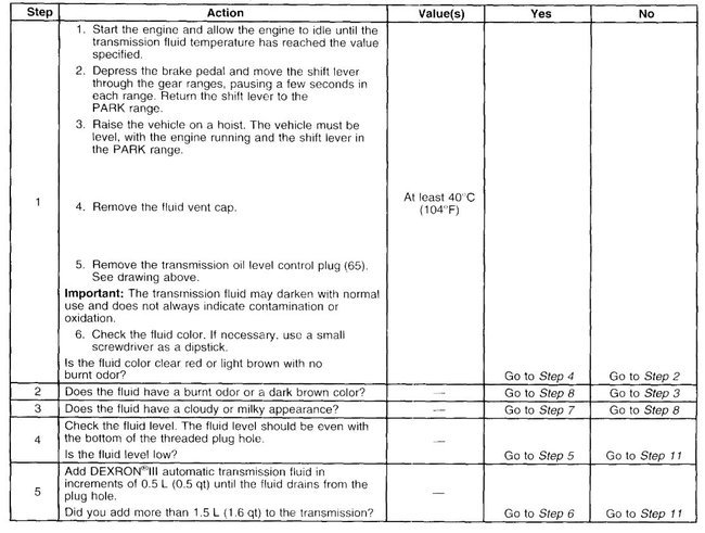

How do I check the level of my transmission of my car?
Is there a way to do it with out going to a mechanic?
+2
Monday, August 6th, 2018 AT 1:19 PM (Merged)
  • 75,992 POSTS
Transmission level indicator plug is in the side of the trans axle. Bring transmission up to operating temperature and follow the guides below
