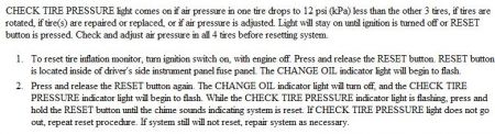

hi my check tire pressure light wont go off. I checked the tire pressure an there all were there supposed to be at. I would reset it but i dont have my owners manual so im not real sure how to do that. thank you for your time.

https://images.2carpros.com/forum/automotive_pictures/139033_4wd_6.jpg
try this. happy motoring

the panel is on drivers side of dash righ when you open the door, it just pops off.
