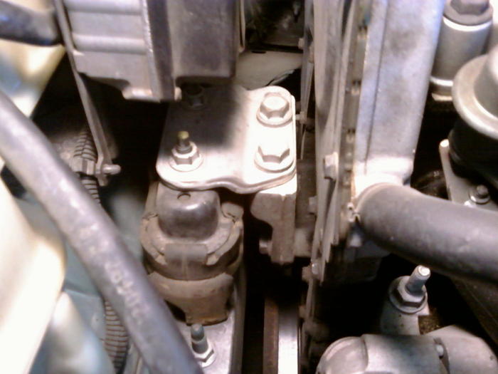

Glad that you responded. I could not have written the description of this issue better. So in trying to discern where the washers should go; starting from the frame, there is a metal bracket bolted there and then the vulcanized rubber bushing. Then there is the another metal bracket sitting on top with two bolts and then it connects to another bracket attached to the engine near the cover with two bolts fastening that. So, where in that scheme do I insert the washers? hopefully that is descriptive enough and here is a picture just to make sure we are talking about the same mount. I am just trying to be perfectly clear so that I just do not have washers in random places. Thanks.

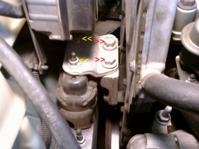

A picture is indeed worth a thousand words! Thanks for including it. I have added arrows to a copy of your picture to make it easier. After jacking the engine, remove the two bolts indicated by the red arrows. Then remove the two nuts on the other side of this bracket indicated by the yellow arrows. One is completely in the shadow, and the other is mostly exposed to the light in the picture. Lift off the bracket, and place the washers on the studs sticking up from the vulcanized rubber bushing. (where the yellow arrow nuts were removed) Reinstall the bracket and the bolts indicated by the red arrows. Lower the engine making sure that the studs line up with the holes in the bracket. Reinstall the nuts indicated by the yellow arrows. Start the engine and verify the repair is complete. The washers should be half an inch flat washers about 1/8 to 3/16 inch thick. Depending on the thickness of the washers, you may need to put two on each stud to eliminate the noise.
Note: If you were to put washers under the bolts with the red arrows, it would make the problem worse by lowering the engine instead of raising it slightly. imgumby!

If the mounts are in good shape, just do the fix. The bolts did not have Locktite on them, but you could use it if it makes you feel safer. I would use the blue rather than the red. The red can be very hard to remove in the future. I am sure that somewhere there is a torque spec for every nut, bolt, and screw used in the car, but I do not have it available to me. I just put it about as tight as it was when I took it apart.
The top bracket does not contact the rubber. It sits on the metal inverted cup with the studs that is the top of the motor mount itself. Just follow the instructions step - by - step, and you cannot go wrong. It really is very simple.
1. Place the floor jack with the block of wood on top of it under the passenger side of the engine near the edge of the oil pan. Raise the jack until it supports the engine. Do nott get too carried away here. You do not want to raise the car with the jack, just support the engine.
2. After jacking the engine, remove the two bolts indicated by the red arrows.
3. Then remove the two nuts on the other side of this bracket indicated by the yellow arrows. One is completely in the shadow, and the other is mostly exposed to the light in the picture.
4. Lift off the bracket, and place the washers on the studs sticking up from the vulcanized rubber bushing. (where the yellow arrow nuts were removed)
5. Reinstall the bracket and the bolts indicated by the red arrows. Tighten the bolts.
6. Lower the engine making sure that the studs line up with the holes in the bracket.
7. Reinstall the nuts indicated by the yellow arrows, and tighten them.
8. Remove the floor jack and block of wood from under the car.
9. Start the engine and verify the repair is complete.
The washers should be half an inch flat washers about 1/8 to 3/16 inch thick. Depending on the thickness of the washers, you may need to put two or three on each stud to eliminate the noise.

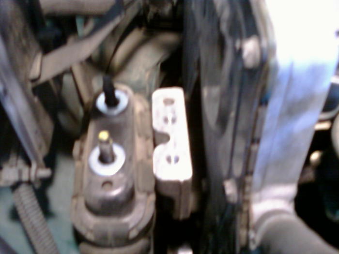

Alright, new pictures.

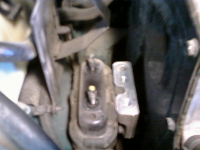

Another where the washers go.

Okay, after doing the job, which only took like fifteen minutes like you said, the vibration still exist and hard to tell if it is better. I just put one half an inch flat washer because when I put two I did not feel comfortable with the amount of threads for the bolt to catch. I also did assume you were talking about metal washers and not rubber. You may have mentioned that but that is where I stand as of now. Let me know if you have anymore feedback. Thanks
