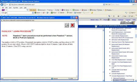

HOW DO YOU RESET YOUR IGNITION THEFT COMPUTER AFTER INSTALING A NEW IGNITION SWITCH MY SECURITY LIGHT KEEPS BLINKING AND THE ENGINE WONT TURN ON ?

https://images.2carpros.com/forum/automotive_pictures/416332_1999_pontiac_grand_am_passlock_learn_1.jpg
There's the information you wanted.
