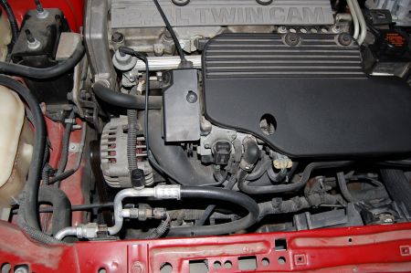

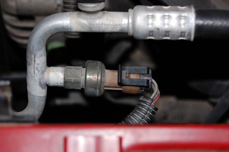

I checked both the top and bottom of the engine: a) underneath the car, next to the oil filter, there is no unit looking like the oil pressure sending unit; that is, there is no component connecting a wire with a duct. b) Instead, on the top, in the front side, next to the radiator, there is a unit looking like the oil pressure sending unit. (please see the attached picture)

A close view is here:
https://www.2carpros.com/forum/automotive_pictures/267046_DSC_0037_1.jpg
Next I unplugged the wire from the "possible" sending unit and see if this is the sending unit. The surprising thing is that when I started the engine, the oil pressure light ran as usual; that is, it was "off" when the engine was running. (My argument is that if the right wire to the dashboard is disconnected, the oil pressure light should be "on" all the time. Am I right?) So, I have no idea of the location of the oil pressure sending unit.
So, Where is the oil pressure sending unit of this car?

The switch is located on the engine block at the R/H/Front corner of the engine, the switch will look like this.
