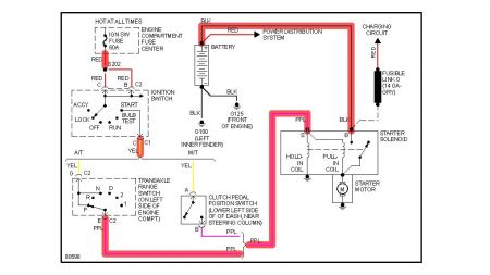

Tune key and notting happens lights on dash work
Sunday, August 3rd, 2008 AT 8:30 PM
MECHANIC
75,992 POSTS
Check ignition switch fuse 60amp, transaxle range switch, and ignition switch -also see below circuitry
