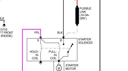

how do i wire a starter for a 96 pontiac grand am. i took it out to have it checked and forgot to pay attention.

See below
https://images.2carpros.com/forum/automotive_pictures/12900_starter_circuit_13.jpg
