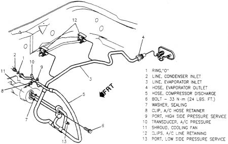

Air Conditioning problem 6 cyl Front Wheel Drive Automatic 165000 miles
I cannot find the a/c low pressure port in my engine. Where is it located???
Sorry to be such a dumba** but I am having trouble orienting the diagram to my engine. Does FRT mean the front of the car? On which side of the car are the a/c hose routing and service ports located? If you could tell me where this diagram is in relation to the overflow container where I put in antifreeze, that would help. I also know where the battery is, where the oil dipstick is, where the power steering fluid goes--if you could tell me if this diagram is near any of those things that would help me find it. Also, does the port have a cap on it? Again, sorry to be such a pain but I am a helpless woman with limited mechanical ability.

Hey Dicewatcher777, The port will be just behind the compressor. Here is a guide that will help you recharge the system. https://www.2carpros.com/articles/air-conditioner-how-to-add-freon
https://images.2carpros.com/forum/automotive_pictures/12900_sp_21.jpg
Please let us know what you find so it will help others. Best, Ken
