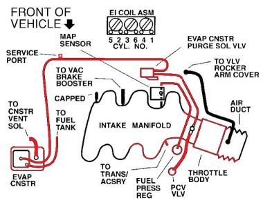

what's wrong when the car rejects gas
May 7, 2009 at 3:06 PM
ZACKMAN
Experienced Mechanic
4,202 POSTS
Fault in the Evaporative Emission System. Need to check your charcoal canister, canister vent solenoid, purge solenoid valve and vacuum lines. I am leaning towards the purge solenoid valve.
