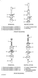

need to replace bushings on control arms,bottom for sure.driver front abs sensor wheel teeth are bad? how about do i go to replace these parts.thank you jim

LOWER CONTROL ARM Removal Raise and support vehicle. Allow suspension to hang free. Remove wheel. Disconnect stabilizer bar from lower control arm. Separate ball joint from lower control arm. Remove lower control arm bolts. Remove lower control arm. Press and or hammer out the bushing NOTE: Tighten lower control arm bolts with vehicle weight on lower control ABS gear is on the axle remove and replace axle
https://images.2carpros.com/forum/automotive_pictures/99387_Graphic1_294.jpg
