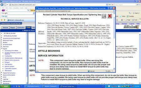

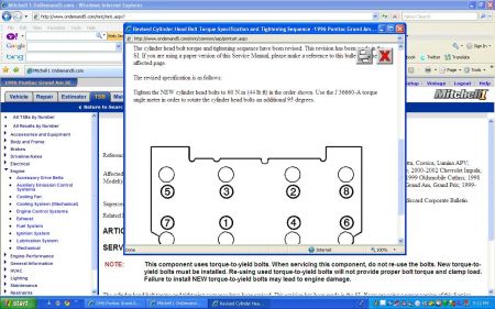

Replacing head gaskets on a 96 grandam. I need torque sequence and torque specs. Thank you!

There you go there's the revised cylinder head tightening.
