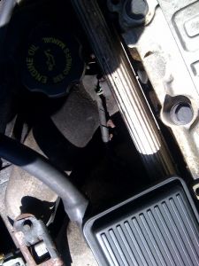

1995 Pontiac Grand Am wheres crank sensor on 2.3 quad4?
1995 PONTIAC GRAND AM
18,000 MILES • 4 CYL • 2WD • AUTOMATIC
TOPPKAT
Do i need to remove timing cover?
Feb 22, 2010 at 1:18 AM
BOSINN
no that sensor is under the intake runners on the front almost center . you dont have to get under the car u can reach it from up under the front of the intake runners..
https://images.2carpros.com/forum/automotive_pictures/509283_securedownload_1.jpg
it has a plug and 1- 10 millimeter bolt.. a 10mm socket ,long extention and a ratchet is all u need .replaced mine last summer..
