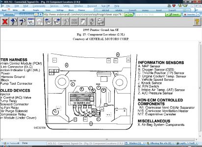

need to know were evaperator canister is located ,to hook up the vaccumn hose

It is located on the passenger side toward the front of the vehicle. Should be pretty close to being directly across from the battery. It may be under something.

https://images.2carpros.com/forum/automotive_pictures/88091_ScreenHunter_01_Oct_08_2235_1.jpg
