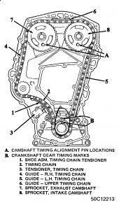

I need to know how to fix my timing chain problem. I recently changed my head gasket. In the process my timing is a little off. I tried to start it and it wont start.

ensure timing marks are aligned properly
https://images.2carpros.com/forum/automotive_pictures/261618_Graphic_348.jpg
