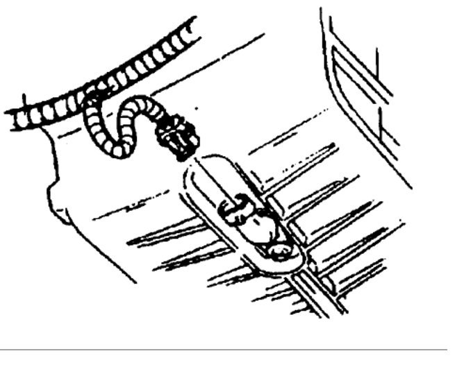

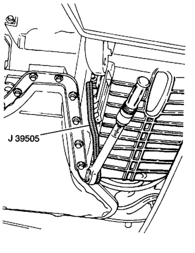

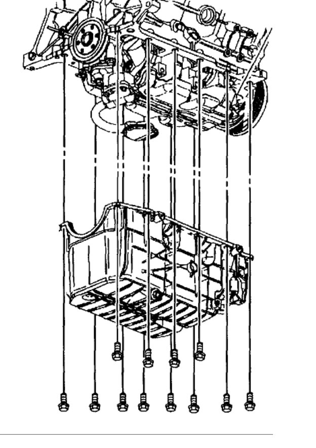

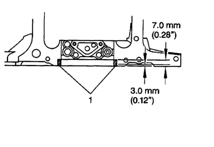

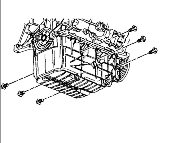

You will need to jack the car up first and then drain the oil.
Here are some diagrams to help you get the job done.
